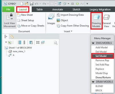

when working with Creo multimodel drawing, user has to set active model - see Creo 10 picture below. Perhaps there is a method that represents this function. You can ask PTC Support ...
