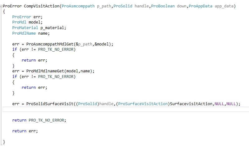

Aravind9813-AquamarineAuthor
Jun 16, 2023 5:28 PM UTC
Hi Sir Thanks For Your Reply.
I need Part material details.
1st i get current model.(ProMdlCurrentGet  )
2nd i visit model components so i use (ProSolidDispCompVisit).
3rd i get asm component path (ProAsmcomppathMdlGet).
4th i get model name.
So now I need Material details, in the main model I Assigned Material for Each Component parts. Now i want to read what material i have Assigned.
PFA
