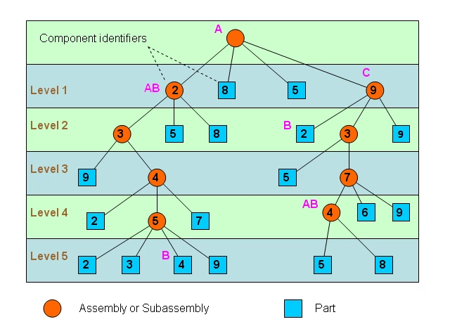

Hi all,
We have ProMdl handle of child;
How to get ProMdl handle of parent assembly?.. So as to get name of the Parent Assembly of the child..
Or is there any other way around or API to get name of the Parent Assembly?
Thanks in advance,
Pratik
RPN
18-Opal
November 29, 2018
