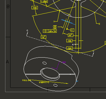

Somehow I lost the section C-C cutting plane.  How do I get it back?
How do I not show the (2) blue lines which I believe are used to construct Section C-C cutting plane.

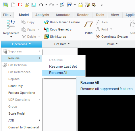

Try to do a Resume all features. The Cross section may have been suppressed accidentally.
dbolden1-VisitorAuthor
Mar 20, 2017 5:39 PM UTC
Where do I find Resume all features?

I managed to get the section view back but I cannot get rid of the blue line "Sketch_2".  I do not know what this line is.  When I look at each feature to see where Sketch_2 is, they all just say Section 1.  Any idea how to hide this blue line or at least find out what it is related too?
