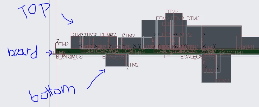

Well, I want to know how to differ the top components from the bottom components placed in a card board after getting all of them with ProSolidDispCompVisit .Capture.PNG

I think, you can analyze Z-axis direction. Compare Z-axis of each component model and card board Z-axis.

Well, I want to get all dispayed components and differ the components placed in top side of the board from the one placed in bottom side.

If you have the ComponentPath of each component you can use Transform3D::GetZAxis to get the location.
Comment: I am working with OTK Java, but should be similar with toolkit...
