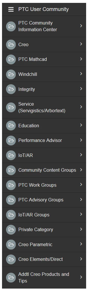

    Not sure what product you are using, but this area is for the eSupport tools on PTC.com.  Things like the knowledge base, case creator, etc.  You will probably have better luck posting your question in the appropriate product area.
