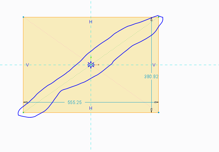

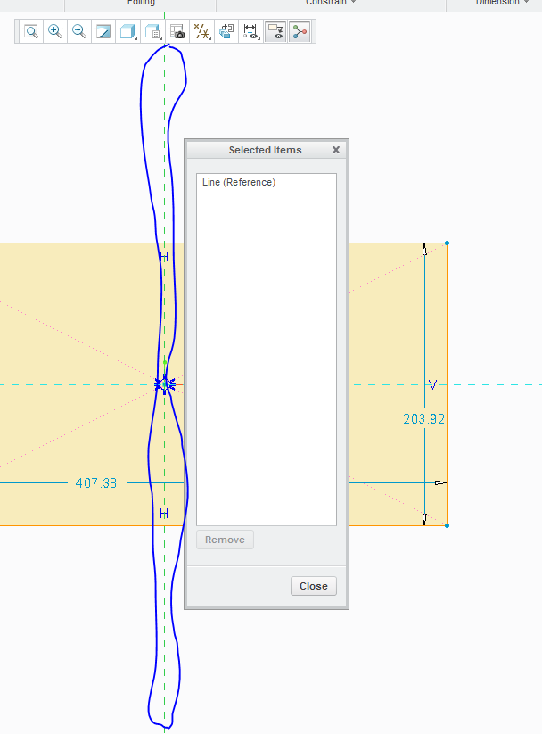

Hi all,
I think the description of lines above isn't clear enough.
Here is a screenshot. I need to understand which lines on this sketch are Reference ones(dashed)?
Or like here in a rectangle (diagonals):
Lines from the first case are marked as Reference, and from second one are marked like Construction.
Is there opportunity to get type (normal, Reference, construction) using toolkit?
I thought it's kinda easy, but can't find any information about these lines.

Jun 30, 2016 9:43 AM UTC
Hi Feliks,
Thank you for the advise. But this function can determine only second case(Construction line, e,g, rectangle's diagonals).
Unfortunately reference lines from 1st case isn't marked as construction by this function.
I selected one of these lines, and it says that these are Reference lines.
Don't know what does that mean. But as for me, it's the same as construction line, unfortunately the function doesn't think that way
Maybe there is some other function for such Reference line? I mean Creo knows for sure that these lines are Reference and should be treated in a special way. I have to be Creo, think like Creo, be Creo
