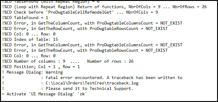

Hi All,
got a problem here that I can't figure out ... and I suspect my lack of knowledge in C language.
So I have this part of code:

So all this gives the below results, for a reason I can't find the variable 'CurrTbl' is becoming empty or something even tough I don't reassign anything to it. Of course later on in the code I try to work with the table and since it does not EXIST for CREO,  it crashes.
Any idea of what's wrong?

you are destroying your heap and stack by calling this:
error = ProDwgtableCellRefmodelGet(&CurrTbl, 4, 1, ProAssemblyRepeatRg, ProMdlRepeatRg);

this line is absolutely wrong:
CurrTbl = MyTablesCollection[TableIdx]; //ProDwgtable(MyTablesCollection[c1]);
what should be there instead is:
ProDwgtable * ptr_to_dwgtable = & MyTablesCollection[TableIdx];
 all sub sequential code must be changed to use ptr_to_dwgtable.
HIH.
FV.
AlexCote1-VisitorAuthor
Jun 20, 2019 2:43 PM UTC
kind of forgot to show the variable declaration I had ... my bad.
Will modify to add the " * " ... just in case it's part of the problem.
