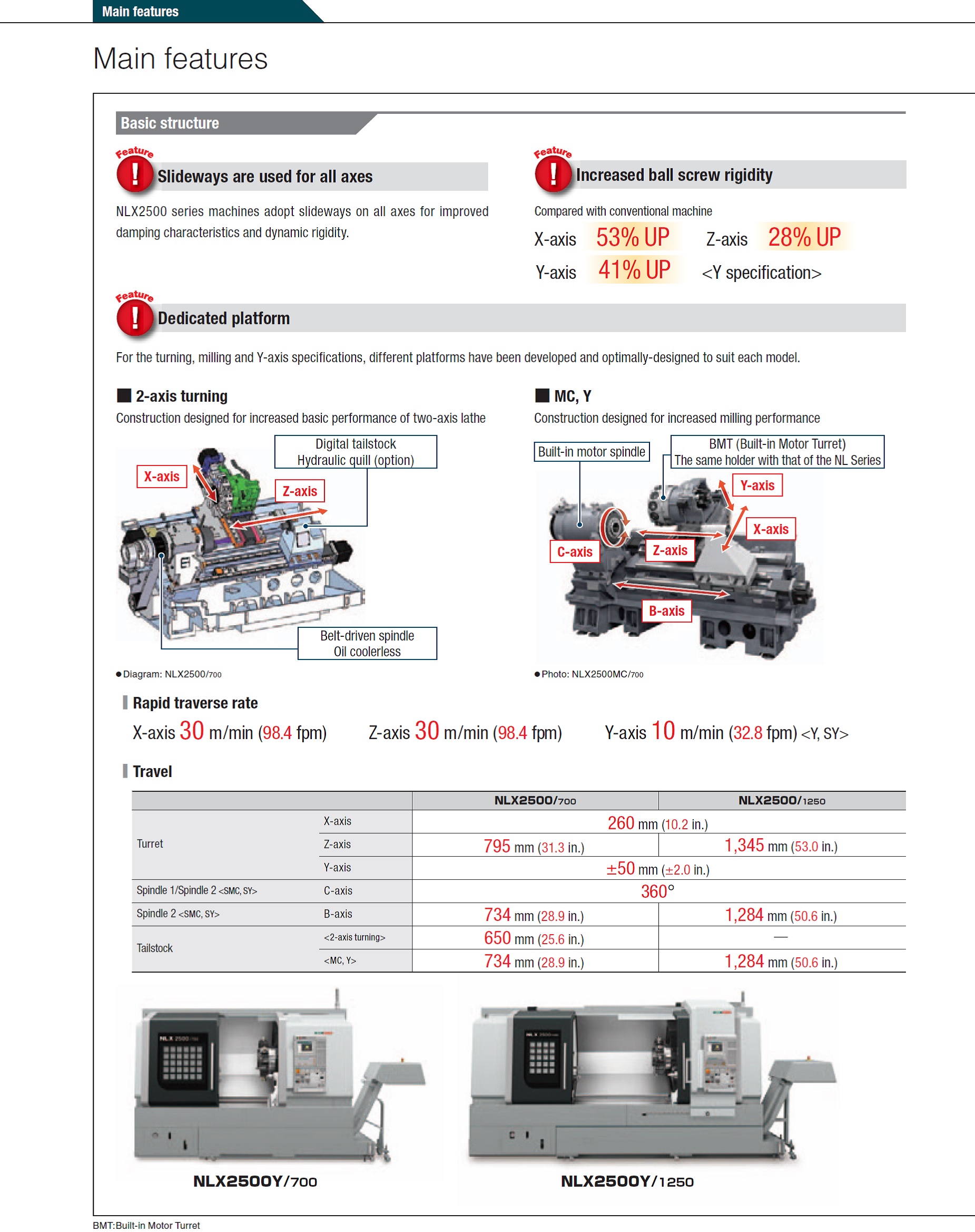

GPost of CREO for machine DMG-Mori NLX2500Y700
Dear
Help me check GPost of CREO for machine DMG-Mori NLX2500Y700?
Ref of machine http://br.dmgmori.com/products/lathes/universal-lathes/nlx/nlx2500+700
*note: This Lathes machine available with C,B axis & X, Y, Z axis
