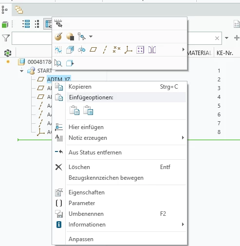

I can’t hide the DTM anymore. Does anybody know how to change that?
Parametric doesn’t display the option to do that. Even with CTRL+H it isn’t possible.
It is just an issue in Assembly and in the Start model. If I create a new ASM model which is empty, then it works. There must be an option or something.

Hi @OS_11014878
Can the entire group be hidden?
Your screenshot crops out most of the Creo window.  Does the View Tab have a grayed out Hide command?  Are these visible in the Layer Tree to modify?
Is this model showing a combined state in which supplemental geometry visibility is controlled via annotations?
- no, i can hide the group without hiding the content inside.
- yes
-yes
- i dont understand the question, how do you mean that?

Could you share an example dataset of this behavior?
For the supplemental geometry, I am referring to something like CS411822 which has a similar description. More detail about combined state controlling visibility here.
