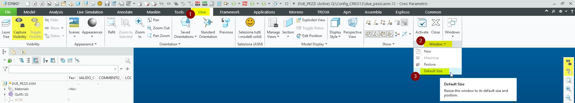

Does anyone know how I can change the default window size in Creo?

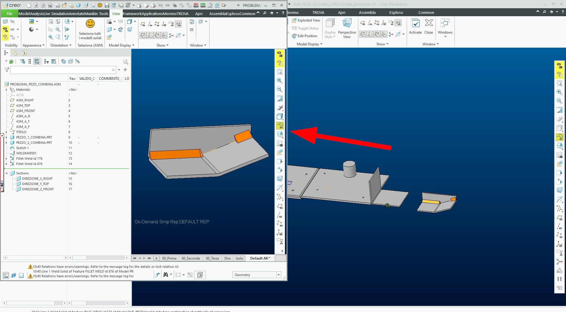

Let me explain better: when I run the command View >>> Windows >>> Default Size,
the window shrinks like this.
Is there a way to get the screenshot at the maximum screen size or a larger size?
Thanks!
P.S. I’m using Creo 12.4.3.0

Update on the issue: it appears that the problem is inside my file "creo_parametric_customization.ui".
I tried starting a new Creo using my config.pro and mapkeys.pro files, but excluding my creo_parametric_customization.ui file. Creo started successfully and created its own neutral/default creo_parametric_customization.ui file. In this situation, the command “View → Windows → Default Size” keeps the window maximized.
It is the same file I started using back in Creo 8. I think the time has come to be patient and recreate my creo_parametric_customization.ui file from scratch.

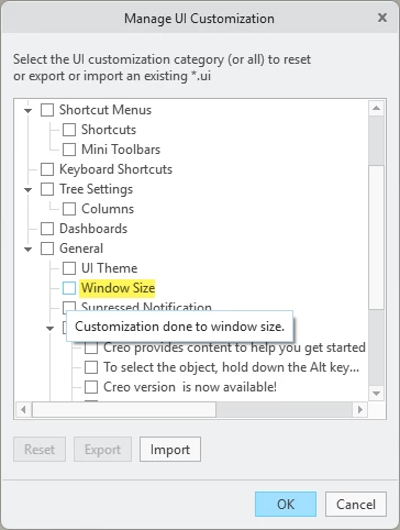

You may be able to modify your existing .ui customizations by changing the window size option shown below.
bmancini15-MoonstoneAuthorAnswer
Apr 28, 2026 12:26 PM UTC
I did a few quick tests:
  1. I tried resetting the "Window Size" in my "creo_parametric_customization.ui" through "Manage UI Customization", but it did not solve the issue.
  2. I tried importing the settings from a neutral working "creo_parametric_customization.ui" into my own "creo_parametric_customization.ui", but that did not solve it either.
  3. I tried importing some settings from my faulty "creo_parametric_customization.ui" into a neutral "creo_parametric_customization.ui", and the problem was solved — the screen remains maximized.
Number 3 seems to be the right path. As soon as I have a bit more time, I’ll look into it further.
Thank you very much for your assistance. I was not aware of the "Manage UI Customization" feature.
