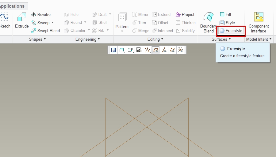

How do you enable Freestyle Modeling in Creo 2.0
I have Creo 2.0 M010 installed and heard that the new Freestyle Modeling option is packaged as part of all versions as standard, yet I do not have it.
I checked my Configured Option Modules under License Information and the Freestyle_Modeling_Extension is installed.
Under the Customize the Ribbon, the Main Tabs available are: Model, Analysis, Annotate, Render, Manikin (do not have installed), Tools, View & Applications, no Freestyle Modeling. The Freestyle Modeling command is also not available under the All Commands listing either. I believe Freestyle Modeling should be a Main Tab.
My menu definition.pro file is coming from C:\Program Files\PTC\Creo 2.0\Common Files\M010\text\menu_def.pro, so that should not be an issue either.
Am I missing something? How do I enable an option that I have and is active on the license server?

Aug 9, 2012 8:14 PM UTC
Freestyle is just a command in the Surfaces group.
Hope it's what you are looking for.
Regards.

Aug 14, 2012 4:56 AM UTC
Hello to all,
there are two different licensed modules:
Creo Freestyle Design (code 325) and Creo Flexible Modeling (code 326).
Creo Freestyle Design was automatically added into any Creo Parametric license (in Creo 1.0). It is free of charge. It enables user to create freestyle features.
Creo Flexible Modeling is commercial module. You have to buy Creo Flexible Modeling Extension, if you want to use it. It enables user to modify existing geometry of the model using Direct Modeling functionality. User cannot create new geometry.

Aug 14, 2012 9:35 AM UTC
Thanks Martin for your input. You speak of "Flexible Modeling" & "Freestyle Design" modules, but PTC referred to it as "Freestyle Modeling".
I guess we will have to wait until M020 is released next month to see exactly what is included or not. I do not believe that Freestyle Modeling is a freebee at all in Parmetric for the Tab in the Ribbon is not even an option.
