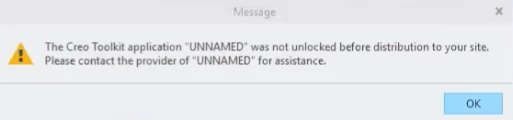

How i unlock my Creo ProToolKit Plugin ?
I was testing my plugin on other system then creo shown this error. How to run Creo Parametric TOOLKIT applications with a Creo Parametric Session without unlocking during application development stage
JB_87049Answer
Nov 11, 2020 9:20 AM UTC
You can unlock your plug-in by issuing the command
protk_unlock.bat
which can be found in the bin folder of the PTC Creo installation, e.g. c:\ptc\Creo 6.0.5.0\Parametric\bin
If your plug-in is called
test.dll
you issue the command
protk_unlock.bat test.dll

Nov 11, 2020 9:43 AM UTC
Thanks @JB_87049
did I need to run this command (protk_unlock.bat test.exe) on all pc in which I want to use my plugin(exe).
Is it asking for My Lic or asking every user to get proToolkit Lic to Use this plugin
Nov 11, 2020 9:47 AM UTC
You need to run this command on your PC only.
After you've done this you can distribute the dll (of your plug-in) to other users.
They only need to install it to be able to run it, nothing else.
