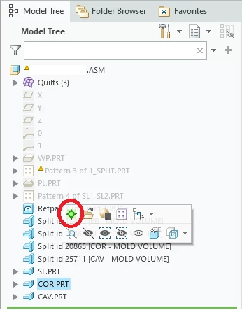

How to activate the model with Creo Object TOOLKIT or TOOLKIT, which function can be activated?
How to activate the model with Creo Object TOOLKIT C++, which function can be activated?

you can select (put into selection buffer) feature and then run macro to activate model (~ Command `ProCmdMakeActive`)

After running the macro, the Toolkit program will lose control of CREO . So I can't use macros to activate.
Jan 12, 2023 4:31 AM UTC
I have not used c++ toolkit yet but in jlink there are 2 functions RunMacro (return handle to Creo) and ExecuteMacro (return handle to toolkit app)
if there is no such function in c++ TK you can try this trick:
register 2 commands with these functions;
1. do the stuff you need then run macro to activating the model and running second macro (eg ~ Command `ProCmdMakeActive`; ~ Command `MyCustomCommand`)
2. do the rest what you need

Use ProWindowActivate() to activate the specified window

Instead of activating the window, activate the model.
Jan 12, 2023 6:10 AM UTC
What do you want to do with active model?
To work with the model from the toolkit application, activation of the model is not required.
Jan 13, 2023 5:56 AM UTC
I want to cut the solid of component B with the quilt of component A .
Now I realize that I don't need to activate the model, but I failed to create the solidify feature because I couldn't select the quilt of component A.
Jan 13, 2023 6:45 AM UTC
I think, pfcModelItemOwner::ListItems can help you to collect surfaces from A model.
