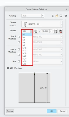

How to add new bolt (M14) in intelligent fastener.
As I shared in the picture below, there are no M14 bolts in the default settings. But designers need it. How can I add this.
March 16, 2021
You have to edit \AFX *version number*\ifx\parts\ifx_fastener_data\DIN931-5.6.dat file. Depending on the version of your IFX the file path may be different. You get better results for IFX questions if you post them here:
