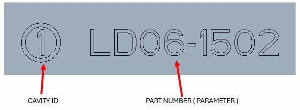

I want be able to create sketch palette item which has a cavity number id reference # and the part number.

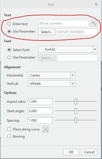

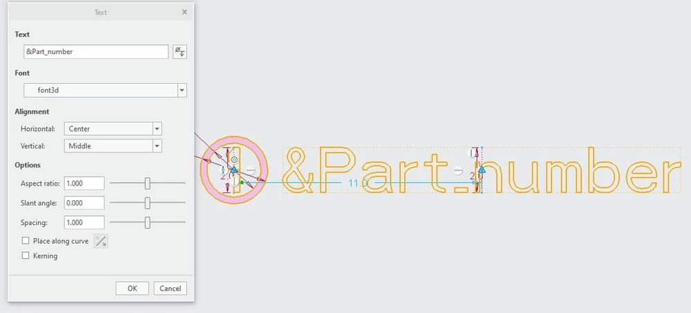

However when I create the sketch for this and want to add text, it does not give me the option to add the parameter it only gives a text option. If I add the parameter name in the text box and save this to the sketcher palette. When I call up this sketch from the sketcher palette in a part, I do not get the part number from the parameter in the model, I just get the text ( &part_number).

The only way I can get this to work is to insert this sketch from the palette and then edit the inserted sketch by selecting the parameter.
Is there a way to add the parameter to the sketch in the palette section, without the need to do a secondary edit.

Try creating the sketch in a part model. It sounds like you're starting as a sketch - and therefore, the Use Parameter radio button is not available. Try the same thing in a sketch created in part mode, and the option will be there.
Once the sketch is created, you can save it from within the sketch interface. The resultant sketch (.sec) file will preserve the parameter. The file can now be included with your sketcher palette.

Thanks for your reply, I have tried this approach, and the behaviour I am seeing is that saved sketch from within the part only holds the paramater value of that part in the sketch for the palette. So when I use that sketch from the palette for a new part the parameter value is shown of the old part ( where the .sec file was created).
Again the only way I seem to be able to rectify this is a secondary edit to the inserted sketch from the palette and selecting the parameter radio button in stead of text.
