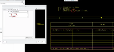

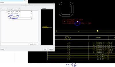

Thank you so much for you respond, It helped me a lot.... but look what I need is to add the real quantity not the sum of all the pieces... we currently have this note which they made long time ago, I put the &rep.qty in the #REQ value so it changed to the sum of all of them not just the 6, this value we put it manually

One more way. Replace drawing symbol by the table with repeat region.
item_no - is a component level parameter.
Create string parameter in the relations for the repeat region - DISPLAY.
This parameter will be drive the visibility the components in the table by item_no component parameter.
In the relations for repeat region
FILTER = 0
IF asm_mbr_cparam_item_no == DISPLAY
 FILTER = 1
ENDIF
The filter for the repeat region:
&rpt.rel.filter == 1
ps: I'm not clear understand the structure of your assembly, but think this is close to what you asked.

So sometimes we put Name_001a and Name_002a into the same sheet and sometimes they (operators) dont have the main table to see the real qty of each item becuase they just have the printing sheet they're working, so that's why we put a custom symbol (a note) to each item into the drawing.

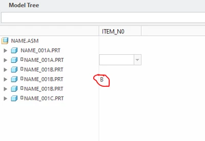

And second one. I have tried this one, and of course that's what I exactly need, it works, I just have a question right here (see image), how to set the "B" as the same name as the other ones, l mean all "Name_001b" is going to have "B" to avoid changing it one by one. and other question, can it be shown just as a text without the lines of the table?
Nov 10, 2021 5:18 AM UTC
1. In this case you need to create model level parameter - item_no. Create in model "Name_001b" a parameter item_no = "b". Then change int table &asm.mbr.cparam.item_no to &asm.mbr.item_no and in the relations asm_mbr_cparam_item_no to asm_mbr_item_no
