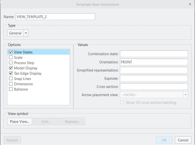

Hello friends , I am new Creo Customization , and I am struck in placement of drawing view in temples , I have already created a template just call it and display it , now I want to add views , please help me to overcome the problem .
Kunal
Jun 24, 2021 3:04 AM UTC
Once you are in the Template mode in the drawing, you can create views from the Template Views option. See snapshot:
Hope this helps.
Jun 24, 2021 12:27 PM UTC
Perhaps I'm misunderstanding your post, but your message makes it sound like the template that you created is empty, that you have created a drawing from template, and now are now seeking to creating views.   ProDrawingFromTmpltCreate does not create a template, its creating a drawing based on a template.
 The purpose of a template is to have the views pre created.  Manually create a template and set up the views as suggested by manju.   Then use ProDrawingFromTmpltCreate to create a drawing and the views are automatically there.
