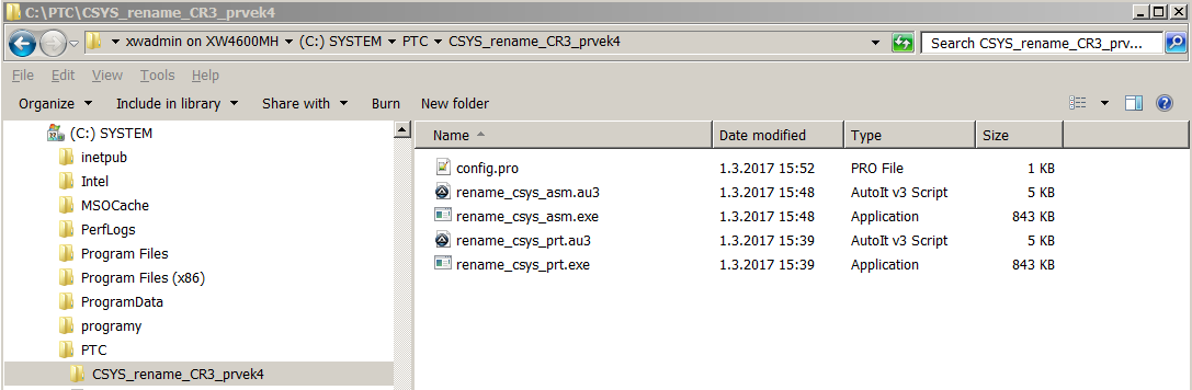

Attached CSYS_rename_CR3_prvek4.zip file contains following files:
How to install script:
  1. create C:\PTC directory
  2. save zip file into C:\PTC directory
  3. unzip zip file into C:\PTC directory to get structure show on picture
  4. open config.pro file and copy two lines into your config.pro
How to run script:
  1. launch Creo 3.0 (in my case it is M100, English version)
  2. open part
  3. run mapkey dd1
  4. open assembly
  5. run mapkey dd2
Notes:
  • .au3 ... source file
  • .exe ... compiled source file
  • if you unzip zip file into directory different from C:\PTC, then you have to modify path defined in config.pro
  • notes in source file are written in Czech language, I hope that translate.google.com transfers Czech texts into English properly
Good luck !

My guess ... you want call mapkey by clicking F2 key instead of clicking dd1 key combination. If this is the case then simply change config.pro line using Notepad.
mapkey dd1 @SYSTEMstart C:\\PTC\\CSYS_rename_CR3_prvek4\\rename_csys_prt.exe;
to
mapkey $F2 @SYSTEMstart C:\\PTC\\CSYS_rename_CR3_prvek4\\rename_csys_prt.exe;
MH

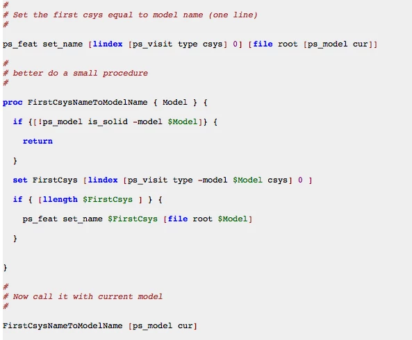

In Tcl I need one Line of code for this:
ps_feat set_name [lindex [ps_visit type csys] 0] [file root [ps_model cur]]
Next a procedure, which is more save:
Here a movie ...
2-Explorer

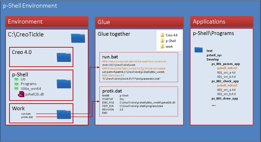

May 21, 2018 3:52 PM UTC
You are almost right, but p-Shell is running in a SandBox, you need to copy one folder only.
The "PNG" shows the env, the movie shows what happen if you add a new folder to your SandBox programs.
  1. Start the Csys app,
  2. keep it running,
  3. do the source code edit
  4. Source the edited file again
  5. Run the newly created button
This is not a final app, but should show how easy it is to make an update or test new code.
Note: This Tcl program run in synchronous mode.
