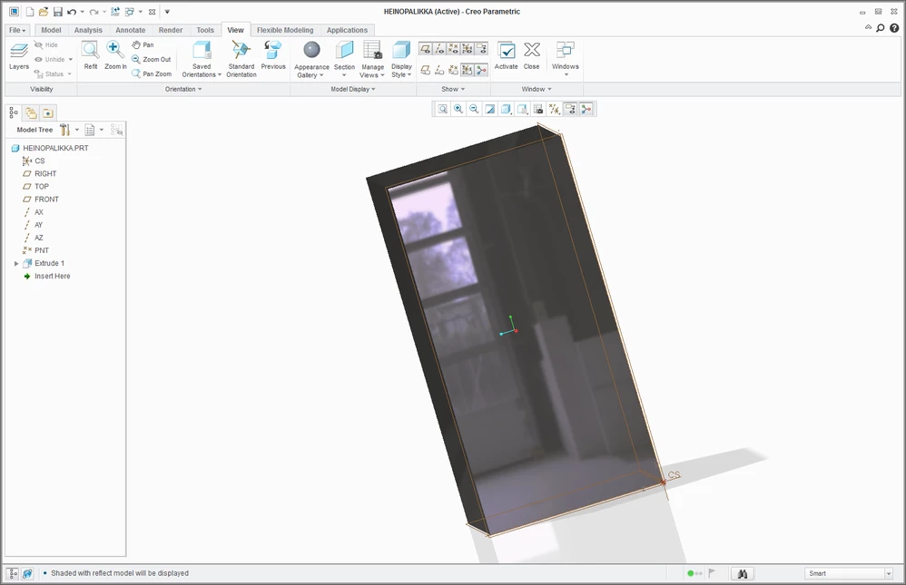

I have would like to assign a spesific photolux color (adv-steel) for my .mtl file but the color won't show up in the model.
Here is the file that I'm trying to use

Jul 20, 2017 12:01 PM UTC
I followed below mentioned steps.
  • start CR3 M120
  • open heinopalikka.prt
  • remove all materials from the model
  • save model
  • exit CR3 M120
  • I do not have PRO_MATERIAL_DIR option defined in config.pro
  • CR3 M120 installation directory ... E:\PTC\Creo3_M120
  • I created bfacj.mtl file in E:\PTC\Creo3_M120\Creo 3.0\M120\Common Files\text\materials-library directory ... I copied its contents from your original post
  • I modified global.dmt file in E:\PTC\Creo3_M120\Creo 3.0\M120\Common Files\graphic-library\appearances directory ... I added adv-steel color at the end of file (55 lines copied from your global.dmt file)
  • start CR3 M120
  • add and assign bfacj material
  • finished

insert the definition of adv-steel color into global.dmt file and ... you are done.
hjarvela1-VisitorAuthor
Jul 20, 2017 11:05 AM UTC
I did exactly what you said but it's not working...
Jul 20, 2017 11:12 AM UTC
please put into zip file your Creo part and global.dmt file and upload zip file using Browse button. I will check your data.
