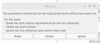

Hi ,
I have suppressed UDF Feature , But dimensions associated with that feature need to be suppressed or delete automatically , But it shows a warning message , The problem is without clicking my program does not step up and end  So I need a solution to avoid warning message
Kunal B.
June 1, 2022
Your drawing throws a warning and suggests 3 possibilities. This is annoying especially if you are not the author of the drawing.
In order to prevent the message again, you need to follow what the warning message is suggesting, make a decision and apply it.
