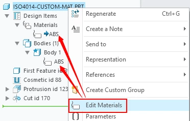

I am developing a custom IFX fastener library. I want to build some fasteners in plastic material. I can easily change the parameter "MATERIAL" so that the string parameter would have any value, but I can't find a way how to actually set the model material in generated instances, so that the weight would be correct.
So far i've tried:
- assigning material in the source file that the instances get generated from
- doing the previous but also adding a line to .dat file "MATERIAL NYLON66" (note that this material is currently assigned in the source part *.prt file, i haven't just used random name)
However, the generated instances still get material "10_9" and density of steel.
How could I set the plastic material in generated instances?

Hi Ben,
you have to change the material from your template fastener file.
Simply assign the material you want.
After creating a new fastener instance from this template,
the material is also available.
NOTE: It is not possible to control the PTC-Material itself by a column in the *.dat file.
The PTC material parameters cannot be modified by IFX.
If you want to use different materials, you have to use an own *.dat file for this.

RPN - I am not using the toolkit, im just modifying the IFX *.dat files for metadata manipulation; and now its clear that I need to update the source fastener file (.prt) with the correct material as explained by Oliver above.
Thank you for your response but I marked Olivers answer as a Solution.

Oliver,
thank you for your help, it has worked just fine when you explained it.
My mistake was that I was modifying the fastener when connected to the WC workspace - so when I opened the fastener it was added to my workspace and I  was modifying (assigning the material) to the fastener in my workspace, when the original fastener at IFX folder remained intact, and unmodified fastener was used by IFX file instance generator.
Now it is working fine, thank you.
