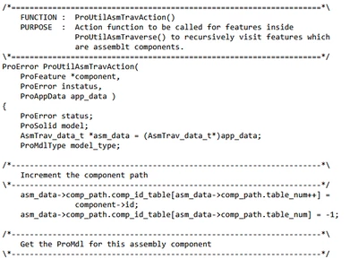

You should take a look at UtilVisit.c in the examples. Copy/paste ProUtilAsmTravAction(...)

You call the visit functions for components, if your component is a PRO_ASSEMBLY you just call your function recursive again.  It’s a little bit like traverse a folder structure. But for sure not the same.
An assembly is like folder, but this folder can appear at the same level or in other levels with the same structure and multiple times.
