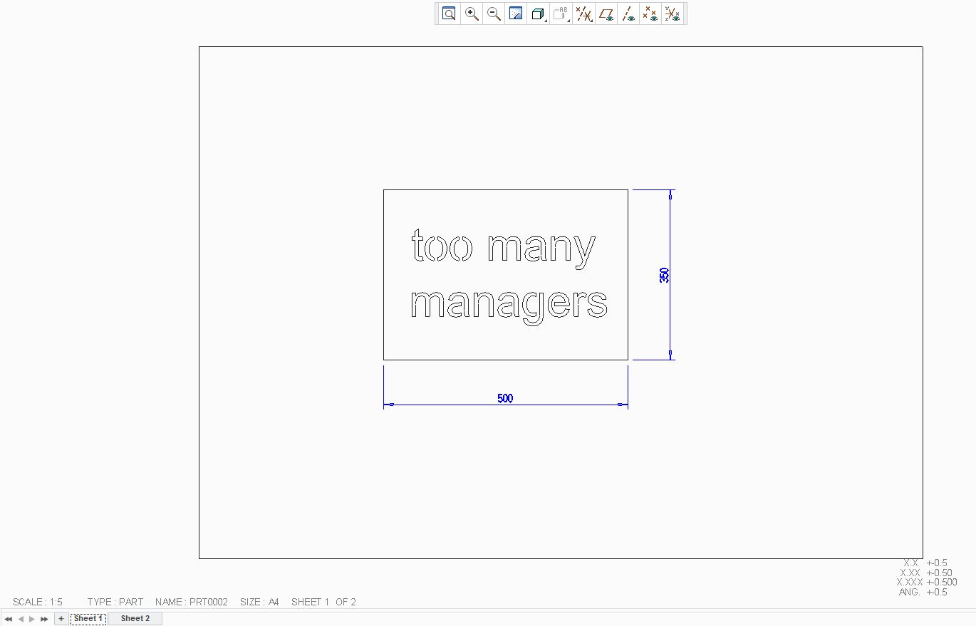

I have hundreds of simple flat sheetmetal-parts that need the same type of drawing as they are only going to be lasercut.
Currently I have to create each drawing manually (both my arms hurt from using the mouse), but I have the feeling the whole process could be automated.
The drawing requires:
Sheet 1 containign a front view with the horizontal and vertical outer dimensions (the scale of the drawing is irrelivant, it should just fit nicely on A4-format).
It would be nice if the model would fit nicely on the sheet (instead of having to re-scale because its way too small). see image:
This sheet is going to be exported to PDF to be used as for reference.

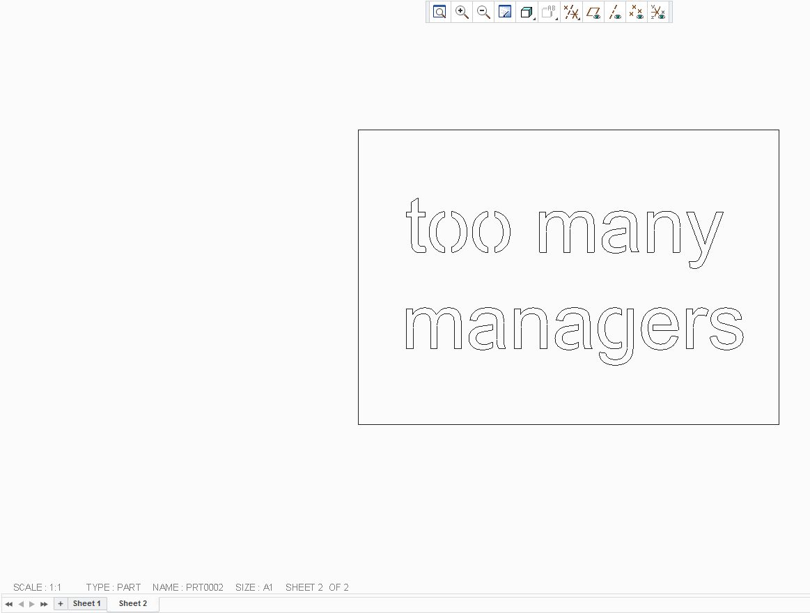

Sheet 2 contains the same view but with scale 1:1. It would be great if the template (which does not show borders) size would always be about 20% larger than the model, so that when I press "Refit", the whole model appears on screen.
This sheet is going to be exported to DXF (and goes into the lasercutter). see image:
