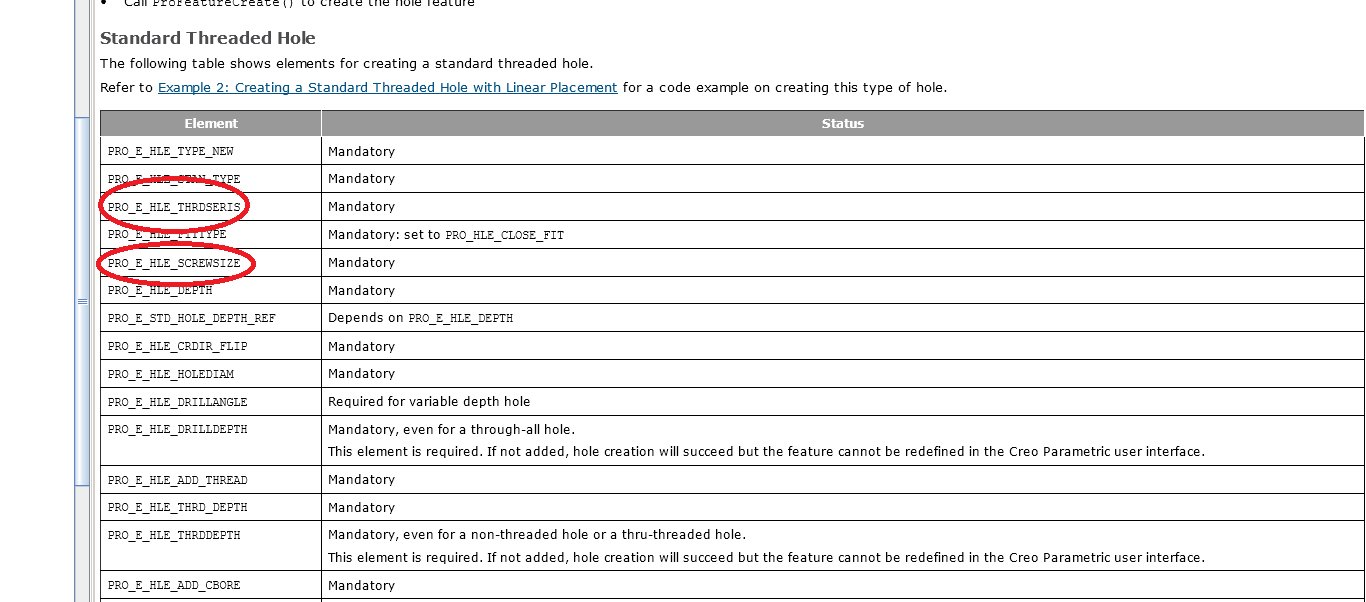

How to create a threaded hole in Creo using protoolkit. I have created a custom hole with a countersink and with a countrerbore. I am unable to use PRO_E_HLE_SCREWSIZE and PRO_E_HLE_THRDSERIS using user guide.

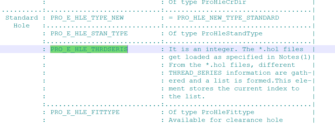

PRO_E_HLE_THRDSERIS and PRO_E_HLE_SCREWSIZE elements are of the type PRO_VALUE_TYPE_INT under common elements of a hole. But user guide does not specify any enumerated value for them.

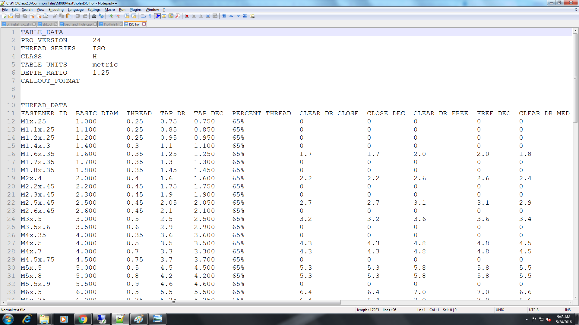

I have tried  PRO_E_HLE_THRDSERIS = ISO and  PRO_E_HLE_SCREWSIZE = 76 (for hole of diameter 25 and pitch 1.5). But the error for PRO_E_HLE_THRDSERIS = ISO is undeclared identifier.
