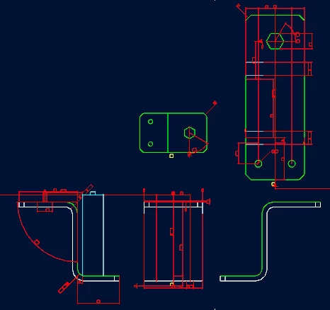

how to create automatic ordinate dimensions for the falt view in creo drawing using Toolkit C++
Team,
I Would like to Create a ordinate dimensions automatically, after finding the flat view in  drawing...
1. code need to find out the Flat View is present or not
2. need to create automatic ordinate dimensions for the view
Please help me to solve my problem
platform: CREO  4.0 M140 / toolkit C++

Apr 20, 2023 6:45 PM UTC
a general answer to a general question...
In order to create a drawing ordinate dimension one would need to create a drawing linear dimension with ProDrawingDimensionCreate(...) and to convert that dimension to the ordinate one with ProDrawingOrdbaselineCreate(...) and ProDrawingDimToOrdinate(...)
The generic approach for finding a specific drawing view is to use ProDrawingViewVisit(...) function and to query each visited view for app specified data, whatever that data might be. When app's data would match view's data the visiting should stop...
HIH

Hi team,
I have used the sample code (Article - CS277961 - The sample code of API ProDrawingDimensionCreate() (ptc.com)) to create the  Dimension for the drawing...
the dimensions are creating for all the views, but i need the dimensions for the only flat view once views are filtered.
even after filtering the specific view ,code is taking the other attachements and creating the dimension,
is there any  other API that is more specific with drawing view instead of Drawing completely?
correct the line of where iam missing for specific flat view attachments.

FV_01
May 8, 2023 5:28 PM UTC
to OP: you would need to collect views relevant to your task with ProDrawingViewVisit(...) prior to running dimensioning code...
on a side note: the following line advances the index past the last element of the array...
for (int j = 0; j <= n_views; ++j){
