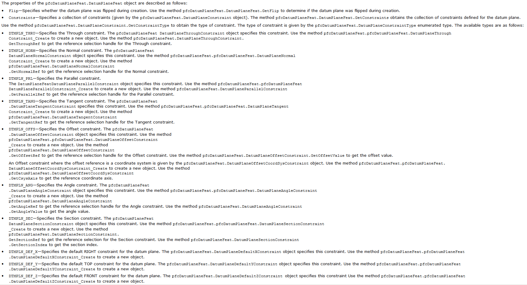

Hi for all!
I need to create offset planes using the j-link.
Does anyone know how to do it?

I don't think that this is possible with J-Link, but you can do it with TK / OTK this way (Just create it on std. system, but you can create it on other positions too) : --> (sry for no comments)
So if it's possible in J-Link it should work the same way, but with Java API wrapper.

Thank Eike for the return, but the problem is that I don't have the TK / OTK, only J-Link.
There is an example in J-Link API that I'm unable to do, as the following image.
Thanks!
