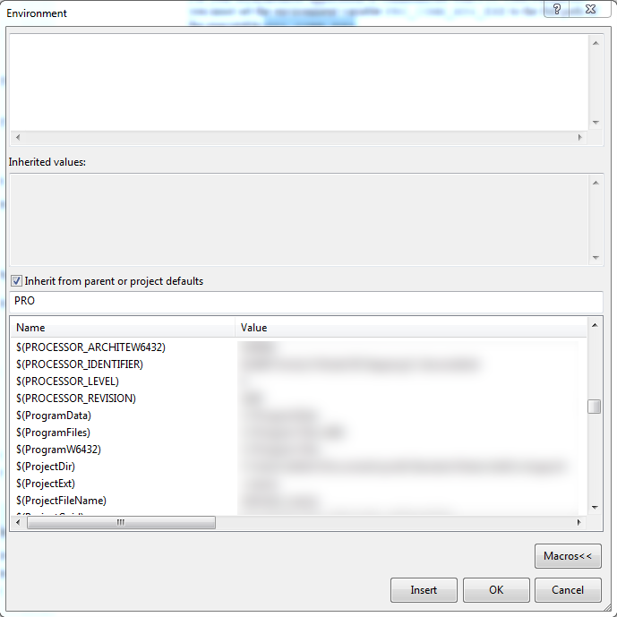

You do need $(PRO_COMM_EXE) in your environment, and there are at least two ways you can set it:
  1. Create the PRO_COMM_EXE environment variable in the System Control Panel.
  2. Set it in Visual Studio under Debugging > Environment. When you edit this field, click the Macros button to see whether $(PRO_COMM_EXE) is already defined:

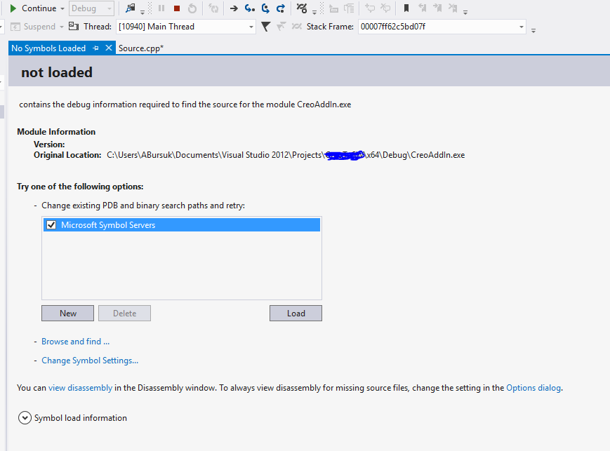

Nevertheless, I can't use debug features(breakpoints, step in, step over etc) with my application.
I got an exception executing my app. But I can't use debugger to find it, it says: symbols.PNG
I have to put several std::cout calls to understand where exception appears. It's annoying.

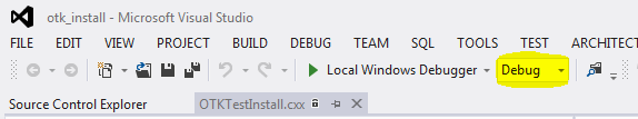

I don't know exactly why you can't attach your debugger, but I suspect that your code was not compiled for debugging. In Visual Studio, I typically have two configurations for each project: Debug and Release. Most of the time, I build and test the Debug configuration. When I'm ready to let my end users test the code, I build them a copy using the Release configuration, which does not have the extra data needed for debugging. This is a typical work pattern in Visual Studio.
My first suggestion is that you check to see whether you are testing a Debug or Release build:
Keep in mind that Visual Studio typically writes the Debug and Release output in different folders, so you also need to edit your .dat file entries accordingly.

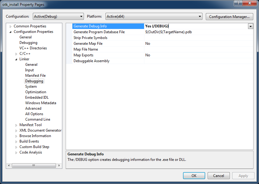

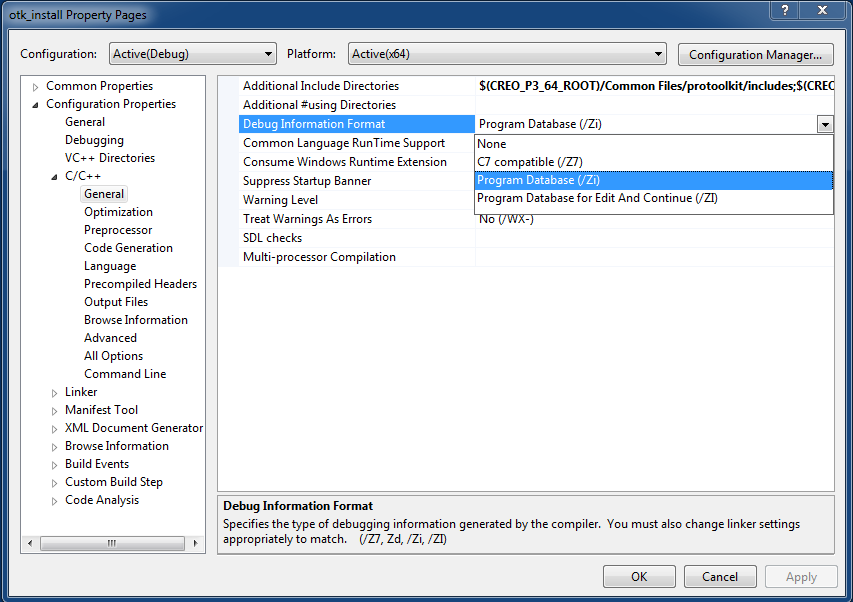

If you are building in the Debug configuration and you still can't attach the debugger, check to see that your are actually compiling your code for debugging:
You will also need to check your linker options:

Thanks, Mark!
I had both options with incorrect values.
Now it works perfectly fine!
