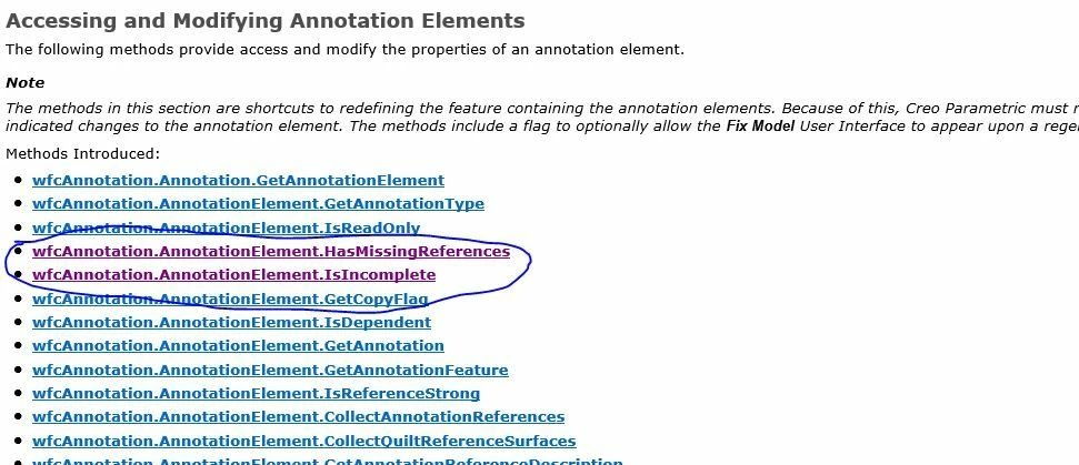

Does this help you? i think the annotations is invalid while  missing the reference or the status is IsIncomplete,
but i checked it in Otkjava, however, Toolkit should be the same

There is a problem with the functions HasMissingReferences and IsComplete (at least in the C library, I haven't tested other libraries)..
E.g. if you have a driven dimension that has semantic references assigned to it, these functions don't detect the references.
