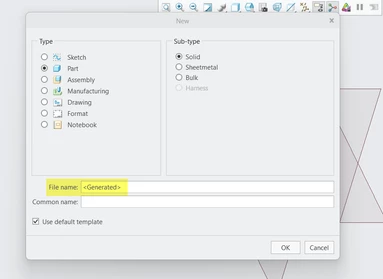

I wanted to enable same numbering logic as Windchill OIR on File Name attribute in Creo while creating new object in Creo.
With current configuration CAD Objects are creates e.g. PRT002.PRT as shown below  :

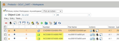

I already can create CAD object as per my define OIR as below :
Please help me to get Windchill OIR configure to Creo to create CAD objects with same numbering scheme.
