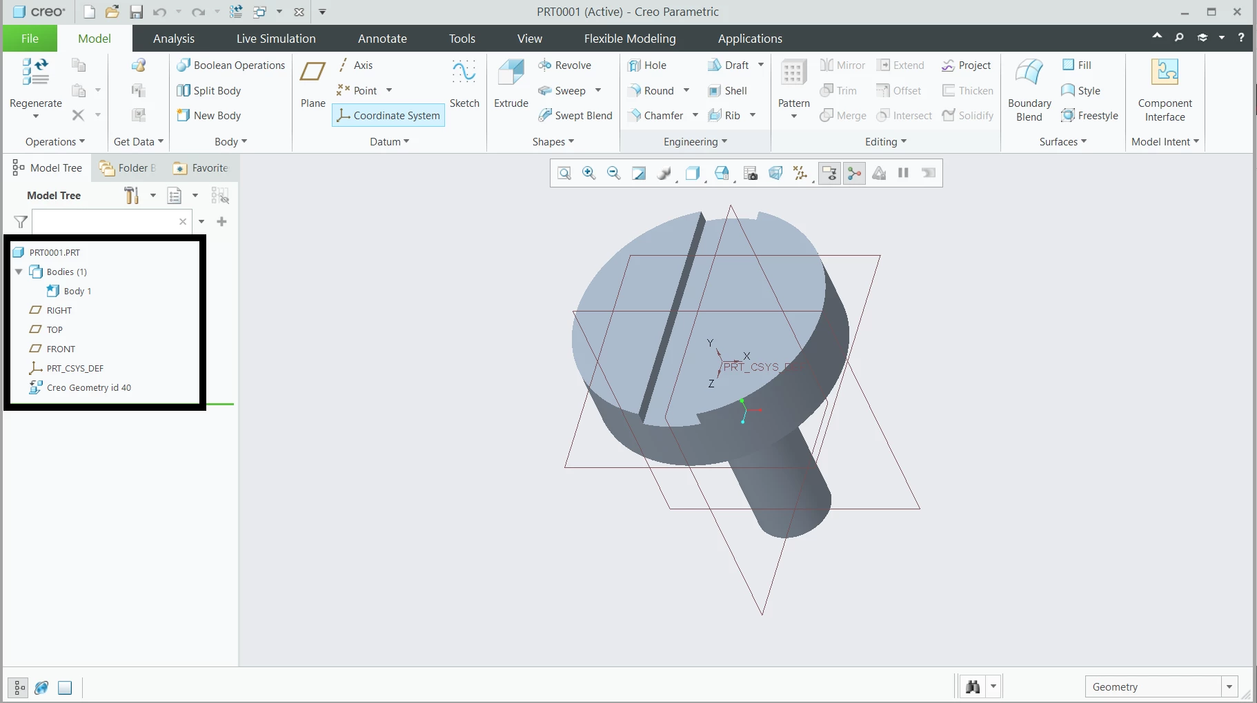

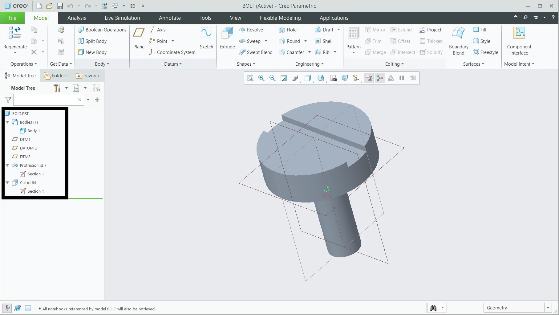

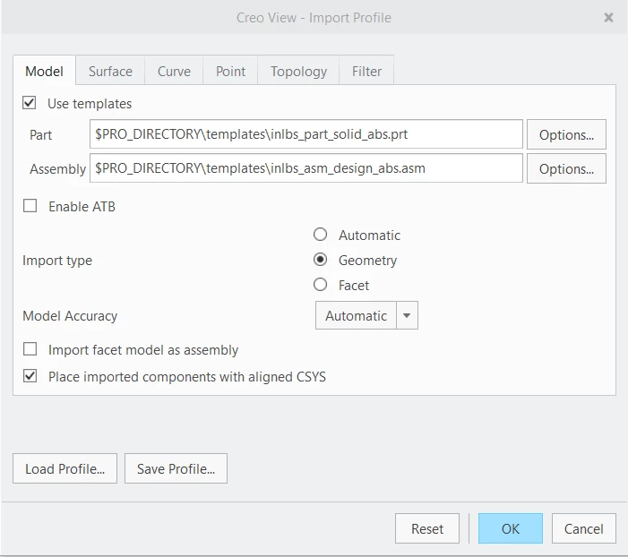

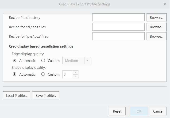

I have tried exporting the part file to Creo View format. But the when I try to import it back, some features in the model tree are missing. I am keeping the default import and export profile options. I have attached screenshots of the import and export profile options, original part and the re-imported part.

From the screenshots you provided, I guess you are interested in retaining the individual features.
This is not what the option "geometry" is about.
"Geometry" means exactly what it says, namely geometry (parametric curves, parametric surfaces) and not a tessellated format (e.g. a model build with only triangles). It doesn't matter whether you use Creo View formats or STEP formats (no matter what AP), they will only retain a "geometry" description of the model.
The only way to retain the individual features is to keep the original model.
