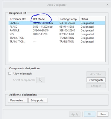

Hi All,
In Cabling environment, I need to get connector Ref_model attribute as shown in below image using toolkit.
I was trying to read parameters of connector but there isn't any parameter which refer to this Ref_Model.
After loading the .nwf file where this Ref_Model is stored to particular connector ?
Thanks in Advance for the help.

Ref_Model - is a model name (name.prt or name.asm) for connector model?
Harsh95921-VisitorAuthor
Nov 24, 2021 7:39 AM UTC

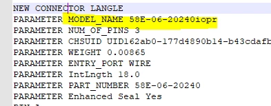

Hi @YaroslavSin ,
No, Ref_Model refers to MODEL_NAME in .nwf file as shown in below image.
Harsh Patel
Nov 24, 2021 8:59 AM UTC
Looks like this is a connector model name from original assembly. The parameter MODEL_NAME is read only and automatically updated to current connector model name. I think, old connector name not stored in new model.
You can try to create PARAMETER OLD_MODEL_NAME 58-06-20240iopr in nwf file to create user defined parameter.
PS: You have PART_NUMBER parameter in nwf. Not suitable for you?
