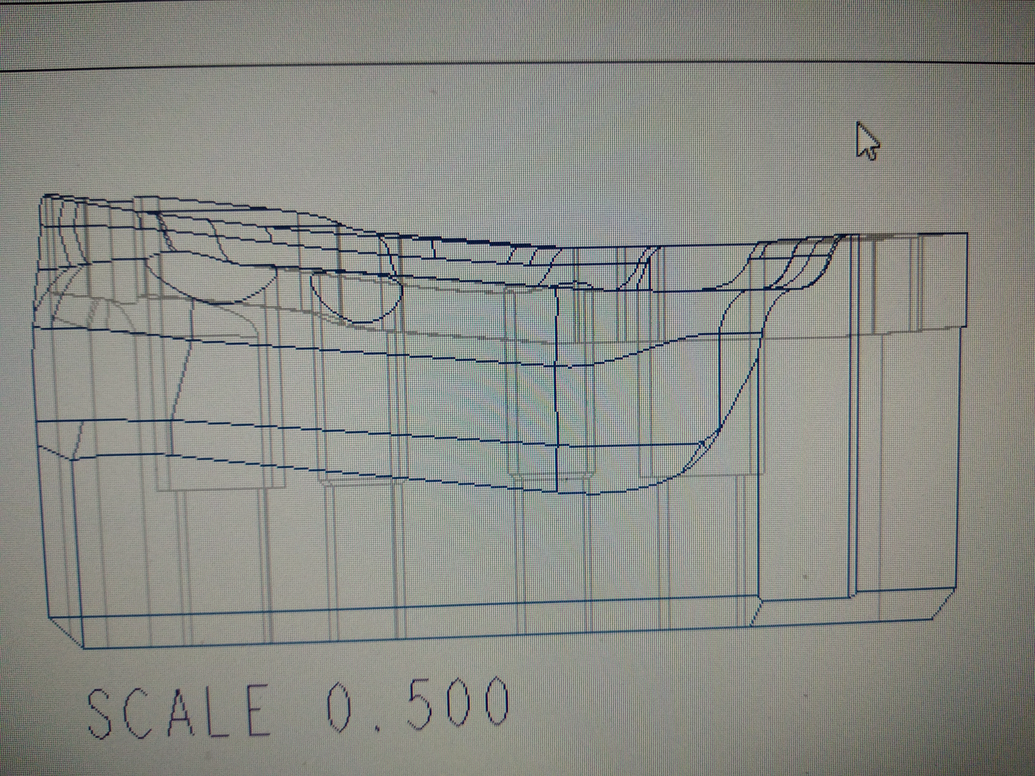

I am struck to get all visible edges in drawing view , I have collect all edge from solid ,now I have to check the edges is visible in view or not , Please help me to resolve the issue .

I have collected all edges in view now I have to differentiate the edge in view using drawing edge display properties , now the problem is ,I find RGB value for edge to collect the edges in Blue colour but for all edges RGB value is same , Please help me to differentiate the edge using its colour in drawing view .

I have collected view , from that I get solid and their edges ,now the problem collected edges are total available edges in model but I want edges in particular drawing view

First change the view display to No hidden and then you can use the Edge Display to select what edges you want to make visible (default).
