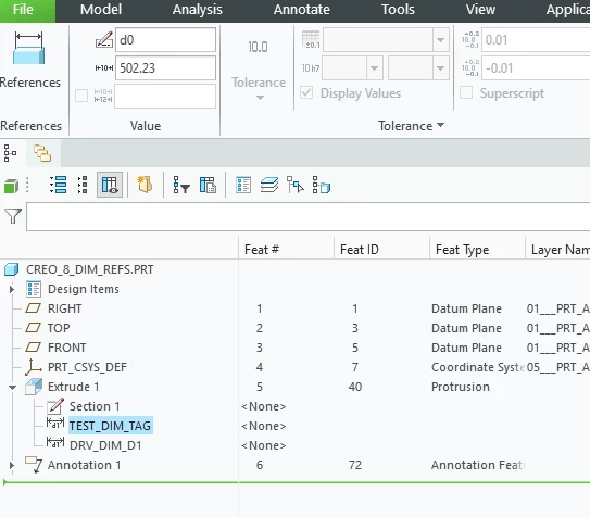

How to get display name of dimension using protoolkit?
I would like to know what protoolkit function is needed to obtain the name of the dimension as it appears in the tree, "TEST_DIM_TAG" in this case.
Calls to ProModelitemNameGet & ProDimensionSymbolGet both return "d0"
Thank you in advance.
Ben_CAnswer
The correct API calling sequence needed is:
ProAnnotationElementGet(p_handle, &element)
ProModelitemNameGet(element, dimTag)
Thanks for the help

Is this a sketched dim, or how was this created?
Ben_C12-AmethystAuthor
I don't believe it is a sketched dimension, but I'm not sure how it was created as this file was passed to me.
File has been attached.
Demensions was shown. This is an annotation items.
