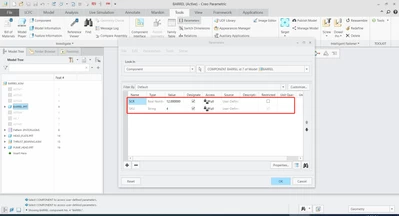

3-Newcomer
September 23, 2022
i use ProSolidFeatVisit() Function could get Assembly components' attribute like name,type . but I don't want this information, because what I want is how to obtain the prt as a user-defined parameter of the component in Asm, such as how to obtain the parameter of the position marked in the following picture? i used ProParameterVisit(),ProParameterValueGet() function can not get what i want
