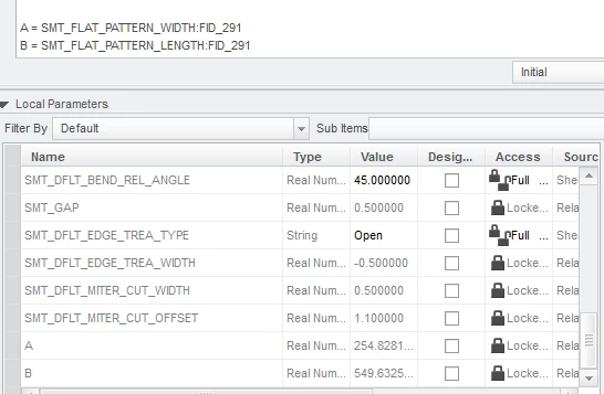

For older models I'd look at IpfcSolid.GeomOutline() or IpfcSolid.EvalOutline() methods where IpfcSolid refers to the flat state of the part (or the flat patern instance if is available).
Either of those functions will give you an array of 2 points representing the extremities of the part. The EvalOutline method has the option to ignore non-geometric features (points, curves, etc).

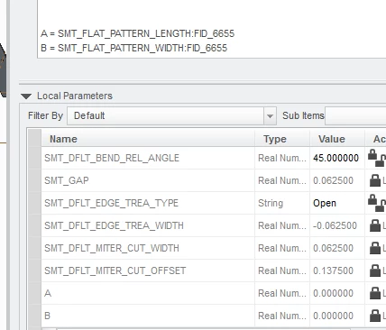

Hi Gabrial,
Thanks for the reply. What ever you told i already tried it up and its working perfetly for a new sheet metal part which i am creating in CREO-3.0.
But the problem what i am facing is. I have many sheet metal items which is too old there if i am trying to acess this parameter i am not getting proper value its always showing 0.0
Please see the attached image's?
Newly created part .
Old Model.
