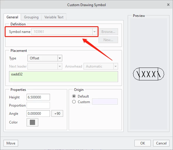

How to get the symbol name with JLink API?
Anyone can guide me get the right JLink API to return the name of the symbol? (Please refer to the attachment  for details.) Thank you!
sjurajAnswer
list model items with enum ITEM_DTL_SYM_DEFINITION or ITEM_DTL_SYM_INSTANCE
then iterate through the list and then GetName of desired symbol

sjuraj15-MoonstoneAnswer
