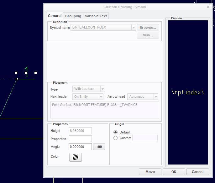

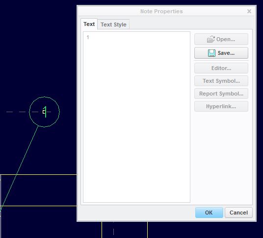

Ok, I see. When i switch to the default Simple Circle bom balloons type and double click on one of the balloons a Note Properties window pops up.
But when I switch to Custom type of bom balloons and use a symbol, which is what i use by default, then when i double click the balloon a totally different window shows up.
Unless you know what text you are looking for inside of the bom balloons or a regex pattern at least then you can't really differentiate between notes and these default bom balloons. So, I'm not sure how to go about without switching to custom type of bom balloon right now.
You could possibly automate the switch to custom symbols and switch back operation. It'd require selection of each table, which is what you can do with J-Link with the following code.
