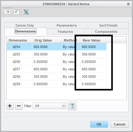

We want to update varied items dimension new value through toolkit app, so please can some one help me to get handle for the flexible dimension.
We have created flexible asm and modified its component dimension. so we want handle for new value to update (highlighted in below snap).

Varied items are handled by hidden family tables. I would look for references to those in the assembly.
