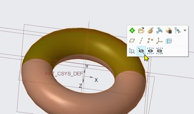

I am using creo object toolkit java to make some secondary developing.
Suppose I have get the ComponentPath of a part or component in an assembly model. Which function can I use to hide and unhide the part or check its hidden status. I read the usergudie a thousand times and could not find one. Belows are functions I have tested.
com.ptc.pfc.pfcModel.Model.Display
com.ptc.pfc.pfcSelect.Selection.Display
com.ptc.wfc.wfcSolid.WSolid.DisplaySolid
Sadly, none of them help.
Does the toolkit provide the function to programmatically hide and unhide part, just like hit the button in this picture?

In summary, the program goes like this:
  • Suppose the part's ComponentPath you want to hide is [40, 43].
  • STEP 1 Get the Model of [40], the part's parent.
  • STEP 2 Get the ModelItem [43] of Model [40].
  • STEP 3 Check if the ModelItem [43] ishidden.
  • STEP 4 If true, unhide it; if false, hide it.
In this way, you can switch the hidden status programmtically.
Here I paste the Java Code.
