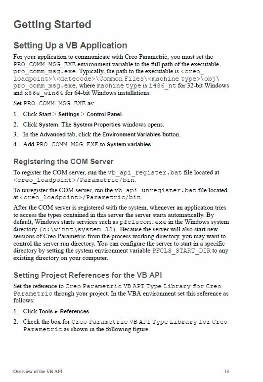

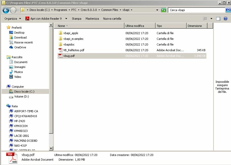

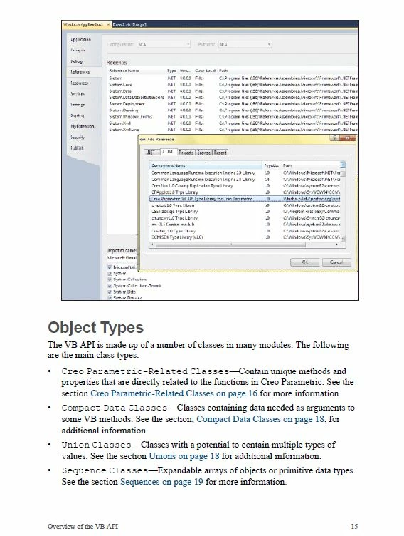

Hi Parthiban,
I'm trying to make the toolkit functional.
What else needs to be installed, see page 14-15 vbug.pdf file on
"C:\Program Files\PTC\Creo 8.0.3.0\Common Files\vbapi".
I followed the instuctions on page 13 up to "Setting Project References for the VB API".
Many thanks in advanced for the time thet you can dedicate to me.
