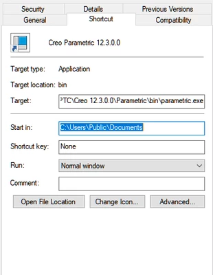

May 14, 2025 10:29 AM UTC
You just need to set the start directory to be where the protk.dat exists, in your case C:\temp
If you have a desktop shortcut, you can modify the properties to change the start directory:
