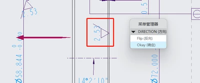

Dec 5, 2023 6:59 AM UTC
But I have a new problem. When my program modifies the variable text of the symbol inside the red rectangle, it prompts me to select the direction of the normal. How to select it automatically?
