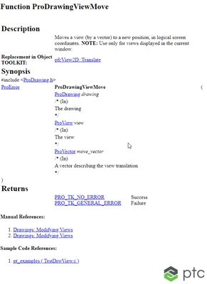

Your application needs to perform the equivalent of RMB on a Drawing view > Move to View. This is a typical instance where a dedicated function exists.
When you search the API documentation with *viewmove" you will find
ProDrawingViewMove
and bonus: pt_examples will give you some code.
Jul 7, 2022 10:08 AM UTC
This API is used to position view not to move annotation from one view to another
Kunal Bidkar

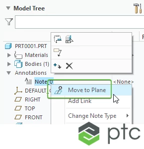

Jul 7, 2022 11:38 AM UTC
That's partially right: this function enables to move a Drawing Note to a different view.  This is my understanding of the topic : "How to Move a drawing Note From one view To Another".
Can you share a screencapture of the operation that you need to run with toolkit? or share some model (even a dumb one)?
By chance do you mean the RMB > Move to plane operation?
