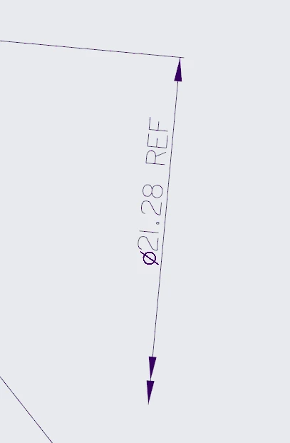

How to move the arrow position of the dimension using toolkit
How can I move the arrow position of the dimension using toolkit.
Please refer the picture.
I didn’t found any specific API.

Try
extern ProError ProDrawingDimensionMove( ProDrawing    drawing,
                                         ProDimension *dimension,
                                         ProVector     location );
  Purpose: Move the dimension to the specified position in the drawing.
           The position before and after the move can be found by
           ProDimlocationTextGet().
  Input Arguments:
     drawing         - The drawing in which the dimension is displayed.
     dimension       - The dimension.
     location        - 3D vector representing the new dimension position.

Hello, thanks for the reply, with this the dimension text is moving but the arrow side where witnesslines has been erased that is not moving.
I want that double arrow head to move :(
