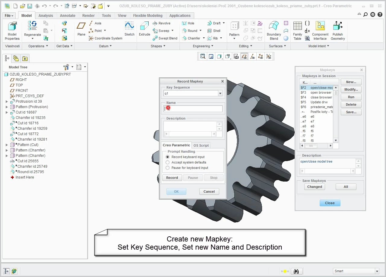

How to open external file with Mapkey
Do you need Open external file or Run some program while you working with Creo Parametric? You can use custom key sequence.
Creo Customization: How to open external file with Mapkey (youtube.com)
