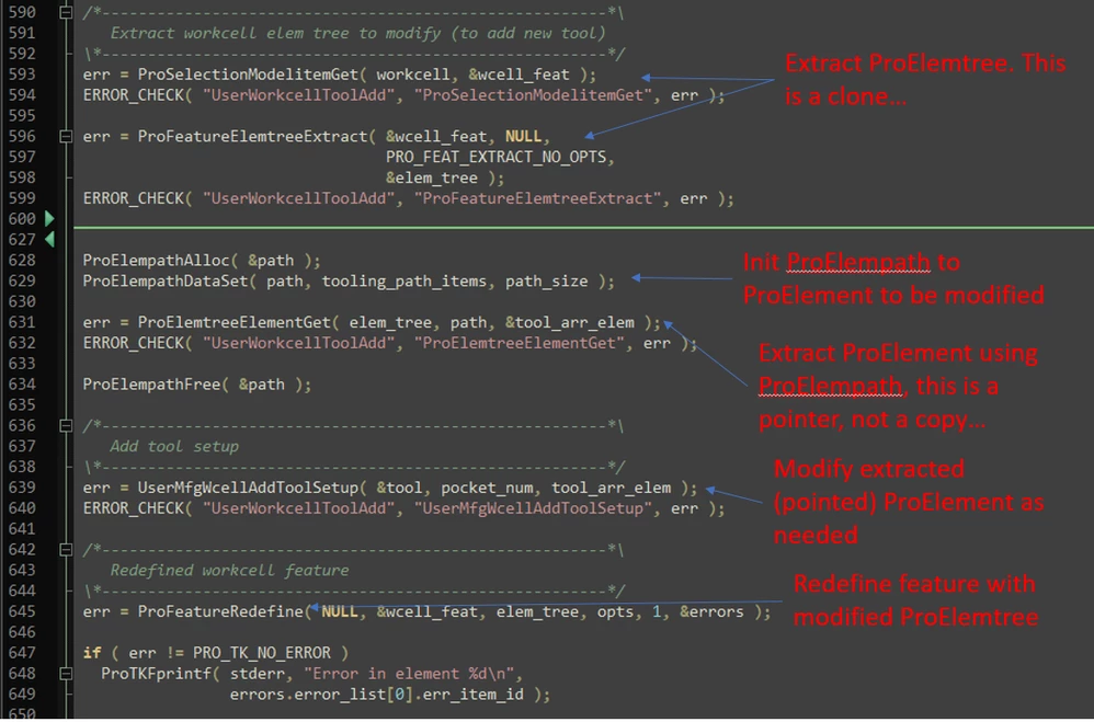

  • manually redefine a hole feature and output its elemtree to XML,
  • modify elemtree of another hole feature and output the modified elemtree into XML,
  • compare two XML files...

take a look at UgMfgWcellCreate.c in protk_appls directory.
It shows a workflow for the feature redefinition process:
HIH
