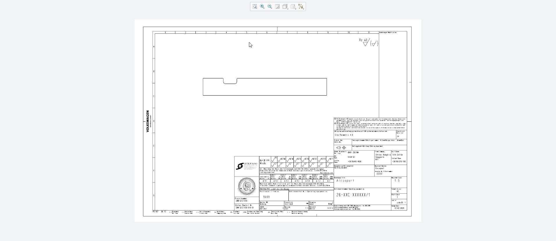

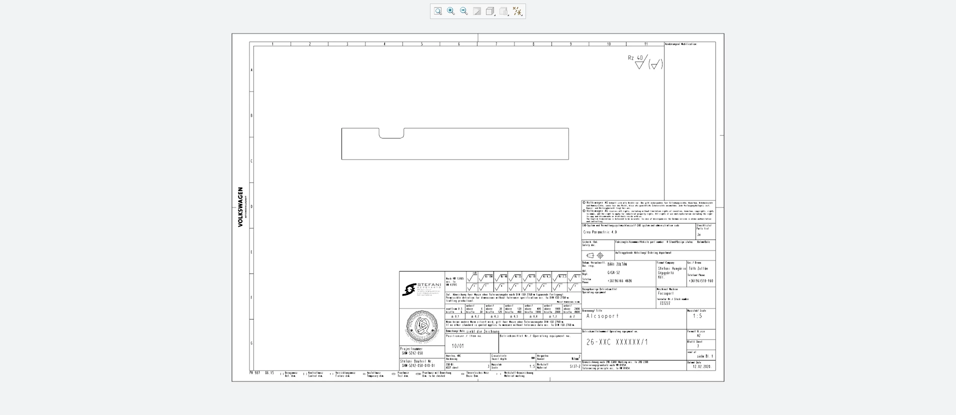

I want automate printing drawings in creo, which mostly works fine with our printer but there is a huge white border around while I use laserjetv4 printer type. Obviusly I can't use MS_PRINTER_MANAGER if I want to automate the whole process. I attached my .pcf file for reference but it doesn't really look like that it has anything to do with it.
Only the "plotter" settings seems to affect the border. Anyone can help me with this problem?
