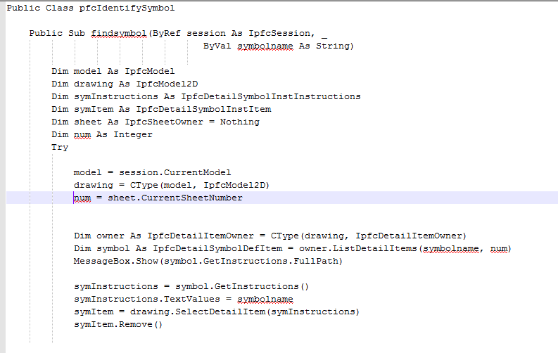

May 4, 2017 11:53 AM UTC
Hi Parthiban Kannan‌
Hello Brother. I have written the code to remove the Symbol from drawing as per your guideline. now i getting an error in the highlighted line in PINK color.
i tried different possibilities but i am not able to select the active drawing sheet. Please show me a way to pass through this.

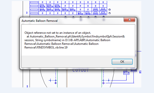

What i want to do is:
1. From the current active drawing sheet in my creo i want to remove all the symbols which user gonna enter.
2.This is the error i am getting.

May 4, 2017 12:31 PM UTC
Hello Aghil Vijayan‌
Dim sheet As IpfcSheetOwner = Nothing
You've assigned nothing to sheet number but called the Sheet Number
num = sheet.CurrentSheetNumber
It doesn't make any logic, that's why it throws an error. You've to assign the model to sheet owner.
I prefer to use for loop with Drawing.NumberOfSheets to check revision symbol in all the sheets

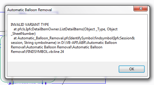

May 4, 2017 1:09 PM UTC
As you said i have assigned sheet owner to the drawing. after assigning  how to get the sheet number or how to make program understand that active sheet is my sheet number.
1. See my updated code :

2. Error Details
As you mentioned in your reply how to create the loop can you give me an idea for that.
