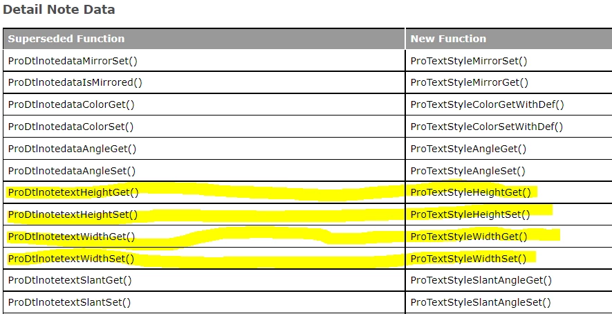

How to set the text aspect ratio through code
I am using Creo Parametric - Release 4.0 (connected) Release 4.0 and DatecodeM010
How to set the text aspect ratio through code? The corresponding API was not found.

    Dear @sxu-3
    You need to set the aspect ratio of a text with Creo Toolkit and found that there is no corresponding API.
    Please go through this comprehensive article about looking for Creo Toolkit functions: https://www.ptc.com/en/support/article/cs324624
    In a nutshell, when developing a Creo Toolkit application, you need to remember:
    1. that Creo Toolkit offers function to run existing operations
    2. if something can be performed from the User  Interface then it is likely with Creo Toolkit
    3. "likely" means that the corresponding API may or may not exist
    4. if it does not exist then, you may file an enhancement request
